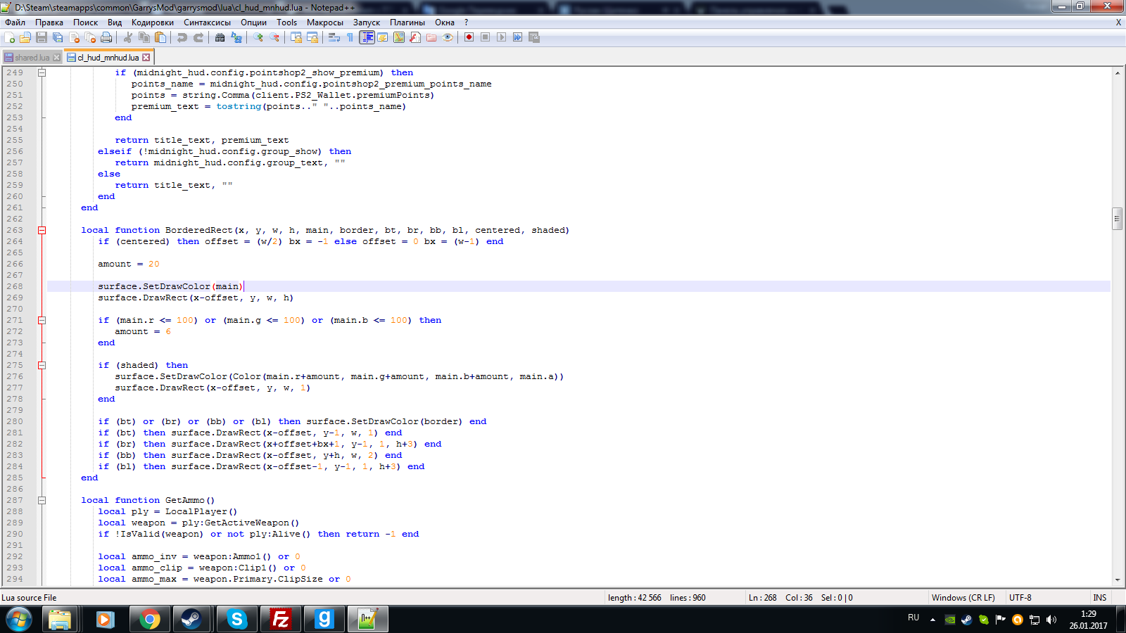

« Reply #2 on: January 25, 2017, 02:33:06 pm »
check this  :'(

« Reply #3 on: January 25, 2017, 02:49:36 pm »
I'd need the whole code. To know, I'd have to find where 'main' is defined and being called (most likely line 865). Please copy it all and use the  tags around the paste, please.
