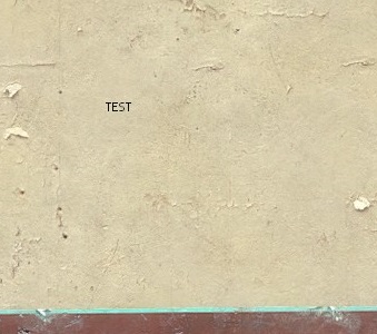

Hi I have some Problems with XGUI.
I create a Tab like in my MSync addon but here it simply doesen't work and even the label I generate is showed but not in an tab .. no its showed permanently on the screen and I dont know what I am doing wrong.

Mhm, that label is showing relative to the player’s entire window, instead of the XGUI window. You get this kind of behavior because you don’t start off with a base panel that has xgui.null as its parent.
You are using some kind of base panel (WoltLabCBridge.back), but it’s never initialized.
Using XLIB, you can initialize it like so:
Code: Lua
  1. WoltLabCBridge.back = xlib.makepanel{ parent=xgui.null }
