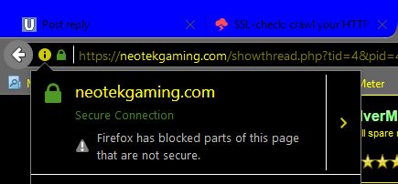

« Reply #5 on: July 30, 2017, 01:24:58 pm »
Alright, I fixed the mixed content thing.
No, unfortunately, you didn't.
I tried your site in Firefox and still says some unsecure content was blocked.
So, I went out and found an online scanner for you.
This site found 200 (it's limit) pages with "HTTP" links to a Google font.
https://www.jitbit.com/sslcheck/#url=https://neotekgaming.com/
It seems your default theme links to an off site HTTP google font.
It's quite likely that you could find the URL in the theme code and change it to HTTPS. Google now hosts https content in it's entirety. (Most http requests get redirected to HTTPS in fact, which is why google.com worked for you without you typing https. As I stated earlier though, USE HTTPS:// when specifying links in ULX MOTD. ULX by default, when you don't specify, adds only http://, not https://)
Once you fix that mixed mode linking, there may be other challenges. Let's start with fixing that one though.
