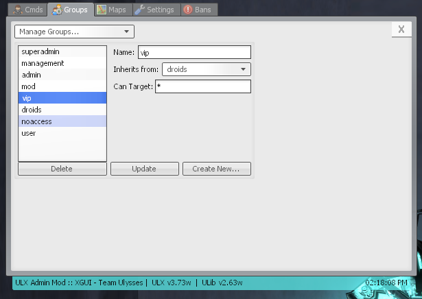

Hello. I am trying to setup an inheritance system. I have it so each rank inherits from the previous one. When i give the VIP rank to my player they don't have access to any commands. When the server restarts they suddenly have access to super admin. I have no clue whats going on and if anyone could help it would be appreciated.

Important trouble shooting is in our FAQs.
Fadmin often conflicts in group access in ULib.
Try disabling per our FAQ link - /index.php/topic,5665.0.html
Additionally, if above fails
/index.php/topic,383.0.html
I'd recommend step 5
