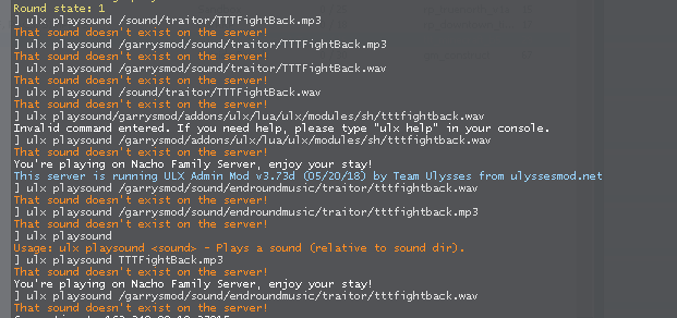

So I'm trying to add end round music to my server. After following mods guide I'm trying to play sound to see if it works. I'll post my command and a snip of what shows in console and what I see in FTP.
Trying to play sound in directory.
Commands used:
ulx playsound sound/endroundmusic/traitor/tttfightback.mp3
ulx playsound /sound/endroundmusic/traitor/tttfightback.mp3
ulx playsound /garrysmod/sound/endroundmusic/traitor/tttfightback.mp3
error given:
That sound doesn't exist on the server!

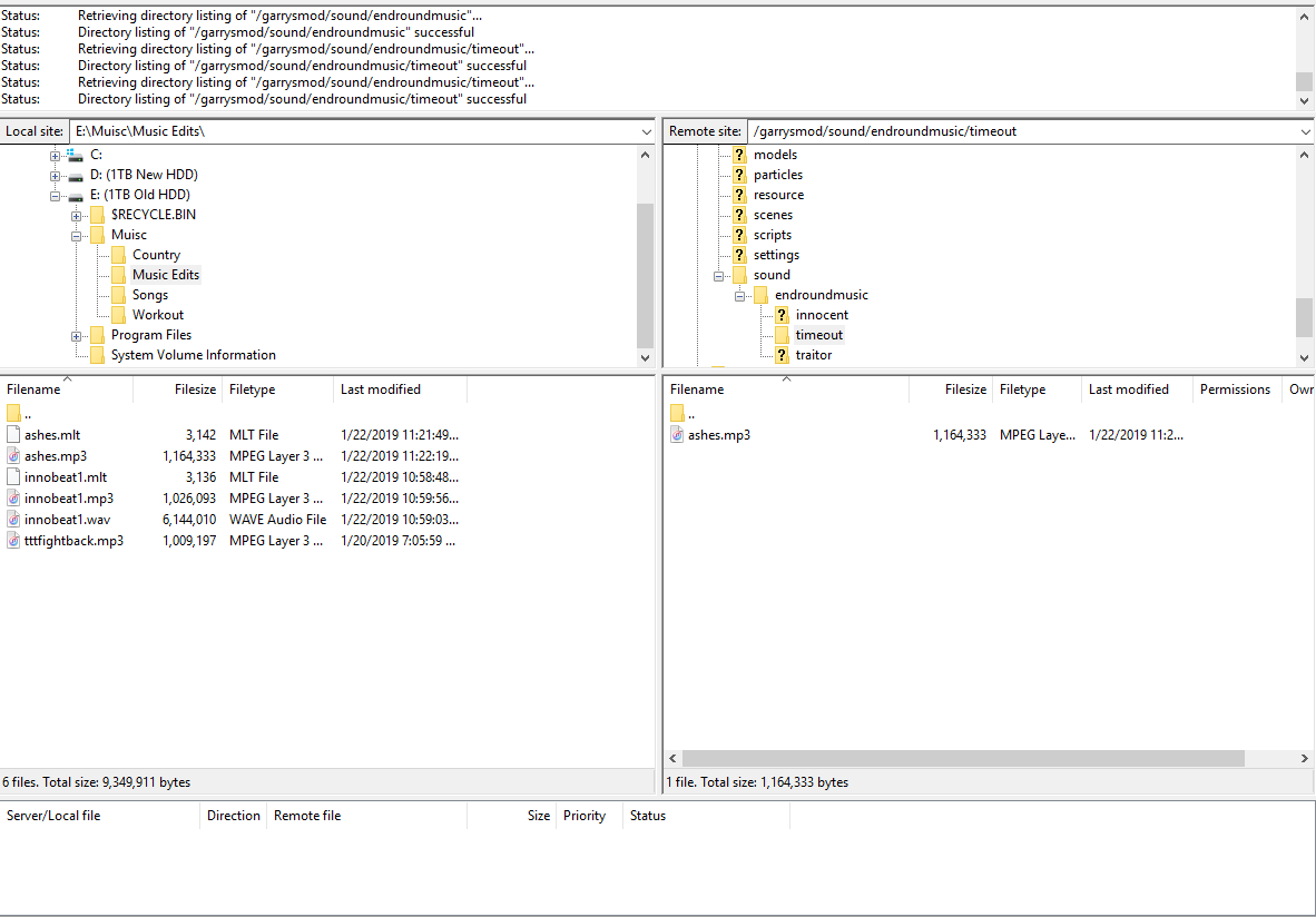

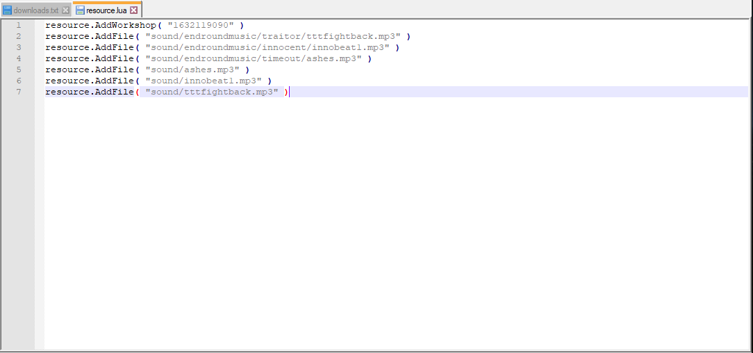

I'm hosting through NFO and I have made a lua/autorun/resource.lua file with
resource.AddFile( "sound/endroundmusic/traitor/tttfightback.mp3" )
resource.AddFile( "sound/endroundmusic/innocent/innobeat1.mp3" )
resource.AddFile( "sound/endroundmusic/timeout/ashes.mp3" )
resource.AddFile( "sound/ashes.mp3" )
resource.AddFile( "sound/innobeat1.mp3" )
resource.AddFile( "sound/tttfightback.mp3" )

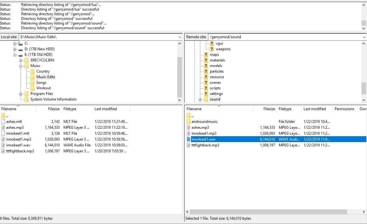

I also aded the mp3 directly in the sound folder for playsound testing.

All your examples attempt to include the /sound directory.
Virtually (as an addon, /addons/blah/sounds/...anything here.wav), or literally (gmod_root/sounds/...anything here.wav"
Don't do that.
99% of all Gmod sound commands EXPECT to have the file in the /sound directory, so what you're asking scripts to do is look in /sound/sound/...folder.../file...
For your first resource.addfile example, simply try "ulx playsound /endroundmusic/traitor/tttfightback.mp3"

Thanks for the reply and help.
Ok I think I got the problem solved. Must have been something with resource.lua not downloading files. Files are downloading fine now.

Now I copied the working sounds Directly FTP to
sound/endroundmusic/timeout/ashes.wav and
sound/endroundmusic/traitor/fightback.wav and even through the files play in sound folder the same file gives me
*** Invalid sample rate (48000) for sound 'endroundmusic\traitor\fightback.wav'.
Any speculation on why the same file works in sound and has a different sample rate in sub directories?
