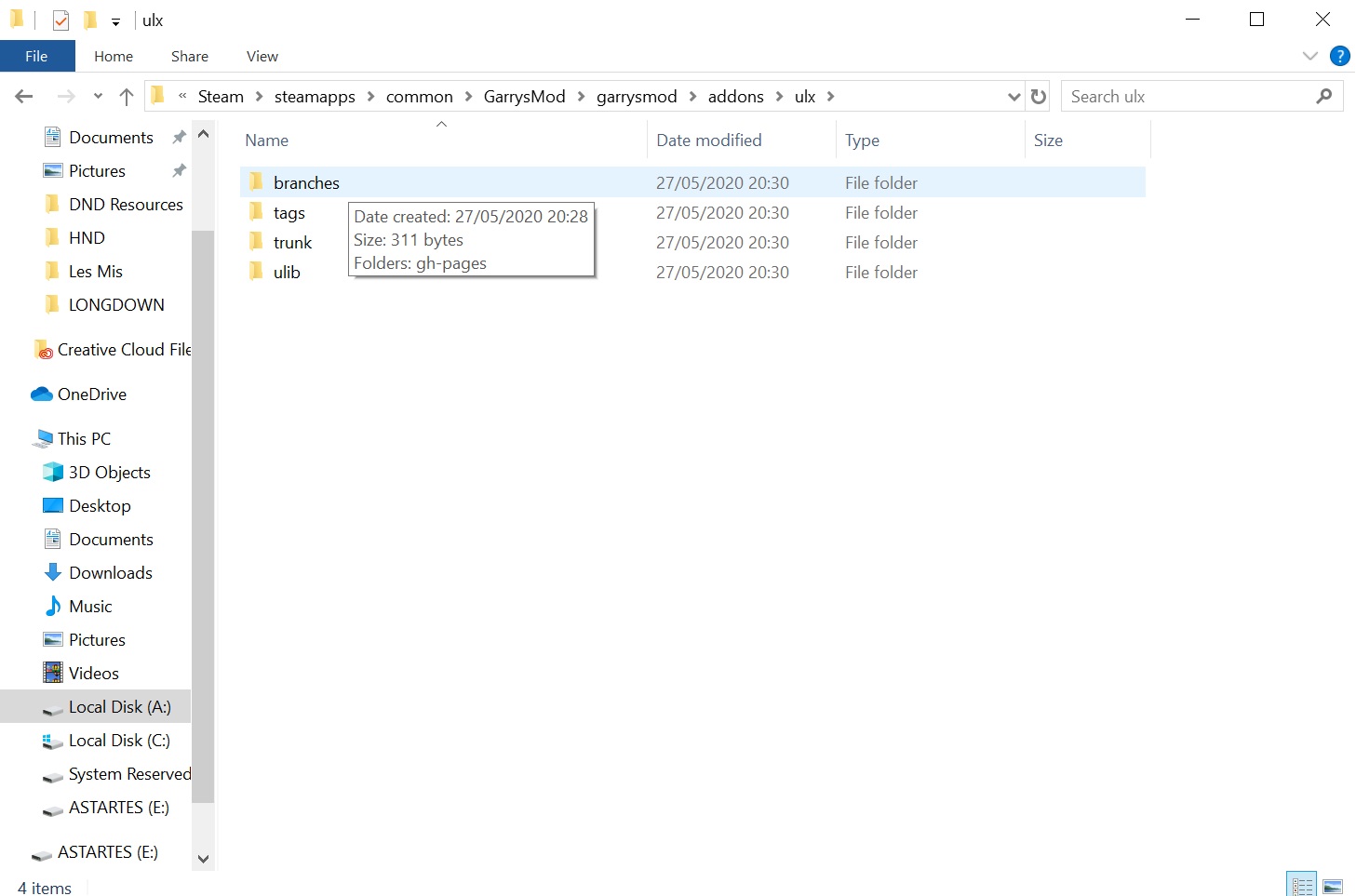

And then I used SVN to put ULX and ULIB into the the add-on folder after reading the instructions on here. I noticed that the pathing/file sequence didn't match up with the tutorial.
Whenever I go into Gmod all the commands associated with ULX don't work, it says it is unknown. I originally had the two seperate files (ULX & ULIB) seperate in the addons solder but that also didn't work.

You should have paths like:
/garrysmod/addons/ulib/lua/ulib/init.lua
/garrysmod/addons/ulx/lua/ulx/init.lua
I've never installed via SVN, only through the legacy archives, so I can't give help there. If you want to just install them like that, you can get them here: ULib and ULX
