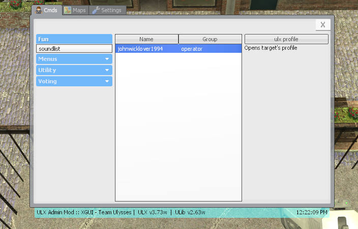

My ULib/ULX versions
ULib v2.63w
ULX v3.73w
Game mode(s) I am having this problem on:
Sandbox
There are no Lua errors.
All of the commands except a select few do not show up in the !menu.
I have removed some ulx-related addons and still no fix. The only current
commands are ones from a command addon I installed just a few minutes ago.
This has been going on for a few months and I have just decided to report it.
Please let me know if there is any way at all to fix this. The screenshot is in singleplayer,
but there is no difference in multiplayer.

The ULX menu only shows commands that you have access to.
By default, users in the "superadmin" usergroup have full access to ULX. It looks like you are currently in "operator".
See: How do I make myself admin?.
« Last Edit: July 17, 2020, 04:41:40 am by Timmy »

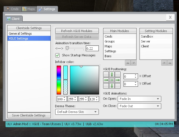

I fixed that, but none of those settings show up in the XGUI. It's just Client stuff. https://prnt.sc/tjp7yu

Again, the ULX menu will show/hide features depending on level of access.
By default, the "superadmin" group has full access.
So make sure you are in the "superadmin" group. I linked to instructions in my first post on this topic.
