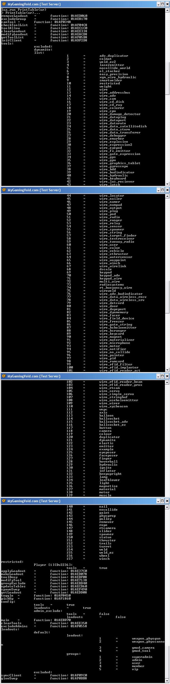

I got the svn version of both ulib and ulx. Now the only guns I have are physgun and toolgun, and when I type "urestrict" in the console, it still says 'Warning: Unhandled usermessage "urestrict"' and nothing happens. The "restricted" tool doesn't do anything either, altough I don't think its supposed to...
     - In your SERVER console type in this command:
lua_run PrintTable(ur)     - And post the contents here.

« Reply #388 on: September 03, 2009, 02:30:08 pm »
I have the same problem as "newbee" in hes pic.
and this is what I get when I type what you wanted him to.

« Reply #389 on: September 03, 2009, 02:36:05 pm »
> PrintTable(ur)...
