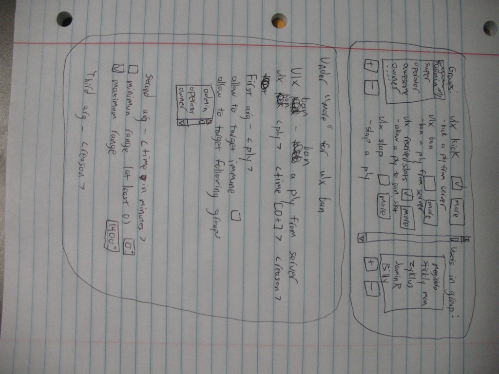

Here's a quick idea I threw out for a possible new UCL config menu. Sorry for my terrible penmanship. :P
The top part is the group configuration. You start by choosing a group (or creating, removing) on the left, users in the group are shown on the right with the ability to add and remove from there too. In the middle is every possible access flag. There's a checkbox to enable/disable access to the specified permission, and the 'more' button.
The menu you get when you click the 'more' button for 'ulx ban' is shown on the bottom of the page. It starts by showing you the command format and then going into specific configs for each parameter. In the case of the first arg, you can specify that the group is allowed to target immune players with this command, or specify groups they can target. The second arg is a little more exciting in this case, where you can constrain the range of time this group is allowed to ban someone. The checkboxes show whether they are constrained to that number or not (how else do we allow infinity?).

Sorry about the image, my computer is showing it rotated perfectly, not sure why it's not showing right here...

I like it.
Re: Photo - Most photo apps can tell when a photo's been taken long-ways and adjust for that using the EXIF data.
Apparently, SMF doesn't :P

An interesting idea with the commands. I've personally been doing a lot of work with low level C and assembly with classes reacently, so to me the whole object oriented approach for a simple command seems a little overboard, but I suppose it may be easier for others to understand. I can also see some potential issues should the occasion ever arise where arguments could be of more than one type.
The menu idea is nice, but I'm not sure every command needs a "More" option. I suppose for specifying who they can target, but I think that's better suited being set per-group. At least a per-group default setting, and then special restrictions can be enabled per-command on those which it is desired.
Also, because I've seen it asked once or twice about SuperAdmin's level of power, I think a warning box that pops up when you try to add a user to SuperAdmin saying something along the lines of "WARNING: SuperAdmin users have full access to all commands. Do not grant SuperAdmin access to anyone whom you would not trust with direct access to the server console. Are you sure...?" (this would only apply to adding through the menu)
