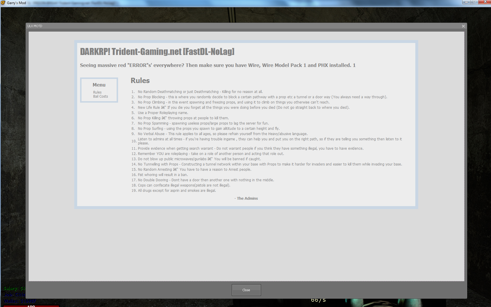

I made an MOTD which used javascript to hide several divs and when you clicked a link one div would appear and another would disappear but since all the recent updates it doesn't work anymore. It doesn't give me any errors and it works fine in Firefox and IE so has javascript functionality been removed or is it bugged?

It is SVN and the MOTD itself is displayed fine its just the javascript within the MOTD isn't working.
*edit*
I just noticed that there is also an issue where some hyphens show up as weird symbols
