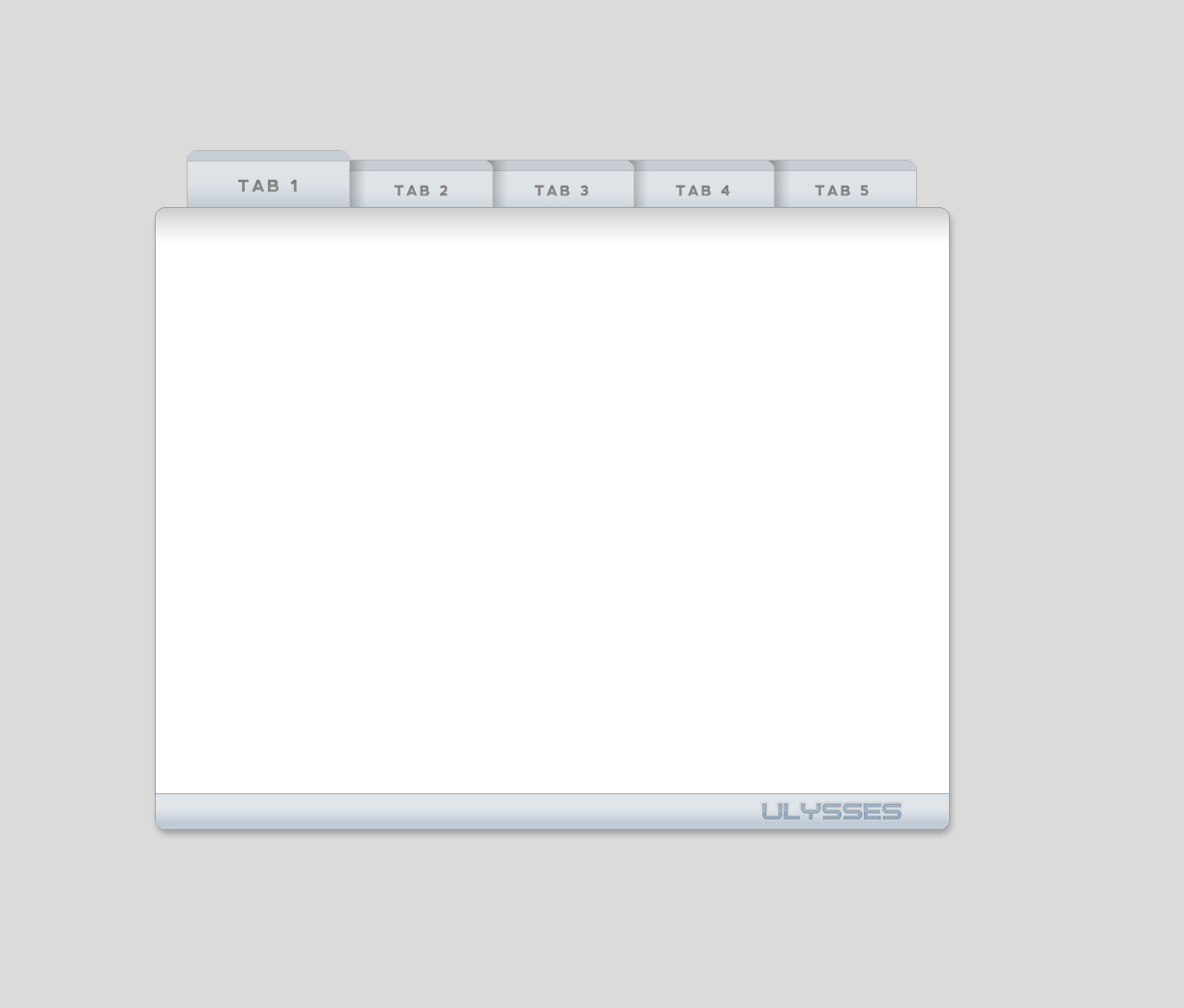

« Reply #8 on: June 11, 2010, 11:32:22 am »
Template, what do y'all think?
Re: PHP Server Queries Useful?
« Reply #9 on: June 11, 2010, 12:50:48 pm »
Looks nice. Are you making all tabs load with page (javascript)? Or does it fetch a new page when you click on a tab (PHP)? I think it'd be snazzy if you made them all load at once so you could switch between them easily, but I guess that largely depends on what you're going to put in those tabs and how big the contents are.
« Reply #10 on: June 11, 2010, 01:41:44 pm »
I'm going to load them all with javascript.
Edit: at least that's the plan :P
