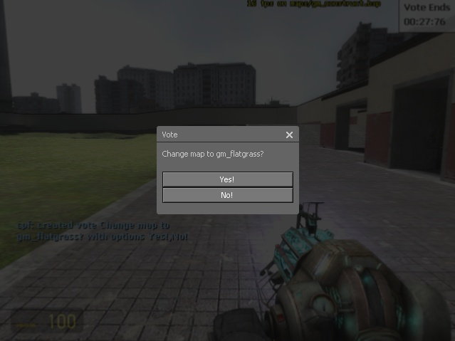

:SetBackgroundBlur is the only thing you really need for the blur effect, the other lines of code just make it so it's always on top, and that you can't switch to any other VGUI/Derma menus.

Yup: http://luabin.foszor.com/code/addons/derma/lua/derma/derma_utils.lua#89
(That's the code for Derma_Message(), which makes a quick blurred popup that you see in gmod) :P
More info: http://wiki.garrysmod.com/?title=Panel.DoModal
