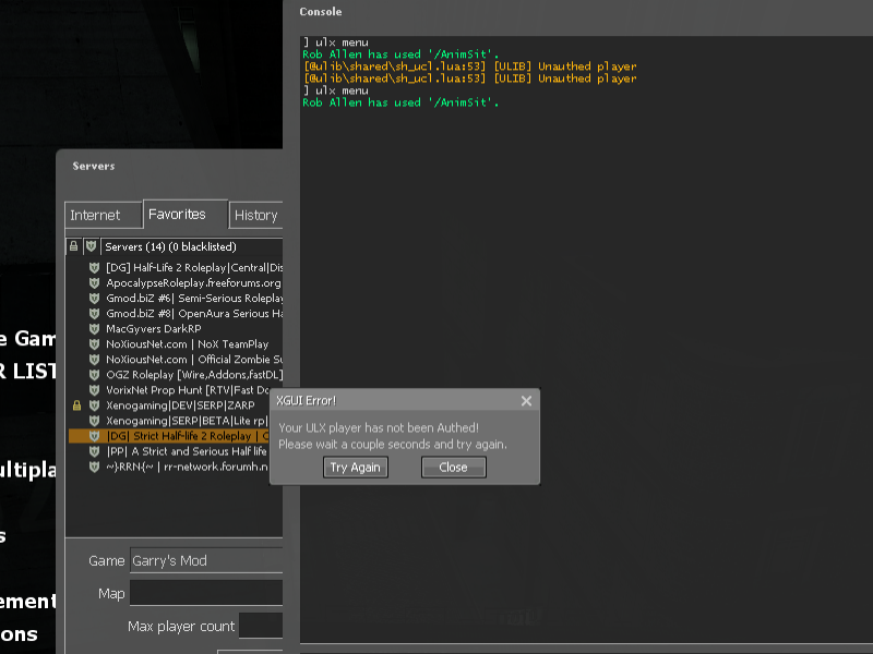

Well, when I go into a server that has ULX and I'm an admin or operator and I go into console and type in ulx then space it gives me...
[@ulib\shared\sh_ucl.lua:53] [ULIB] Unauthed player
Please help me, Renzo.

ERROR: Trying to derive entity sent_keypad_wire from non existant entity base_wire_entity!
ERROR: Trying to derive entity gmod_xqm_wire_hydraulic from non existant entity base_wire_entity!
Sending 467 'User Info' ConVars to server (cl_spewuserinfoconvars to see)
Scanning for downloaded fonts..
Reloading Particles..
Netchannel: failed reading message svc_UserMessage from 109.169.29.99:27015.
Welcome to |DG| Strict Half-life 2 Roleplay | City! We're playing rp_c18_v1. Enjoy your stay!
|DG Dev| Grammar Nazi Renzo has connected to the server.
RunConsoleCommand blocked - sent before player spawned (ZLib_Installed)
ULX version <SVN> unknown revision loaded.
KeyValues Error: RecursiveLoadFromBuffer:  got EOF instead of keyname in file models/sprayca2.mdl
mdlkeyvalue, (*prop_data*),
Redownloading all lightmaps
This server uses WeatherMod v7!
ERROR: Hook 'ThinkForVoiceMute' tried to call a nil function!
Removing Hook 'ThinkForVoiceMute'
//  ULX GUI -- Made by Stickly Man!  //
// Loading GUI Modules...            //
//   bans.lua                        //
//   commands.lua                    //
//   groups.lua                      //
//   maps.lua                        //
//   settings.lua                    //
// Loading Setting Modules...        //
//   client.lua                      //
//   server.lua                      //
//   xgui.lua                        //
// Loading Gamemode Module(s)...     //
//   sandbox.lua                     //
//   No module found!                //
// Modules Loaded!                   //
ERROR: Hook 'InitXGUI' Failed: [@ulib\shared\sh_ucl.lua:53] [ULIB] Unauthed player
Removing Hook 'InitXGUI'
Guessing the Remove of InitXGUI is the problem? If so how do I fix it?
