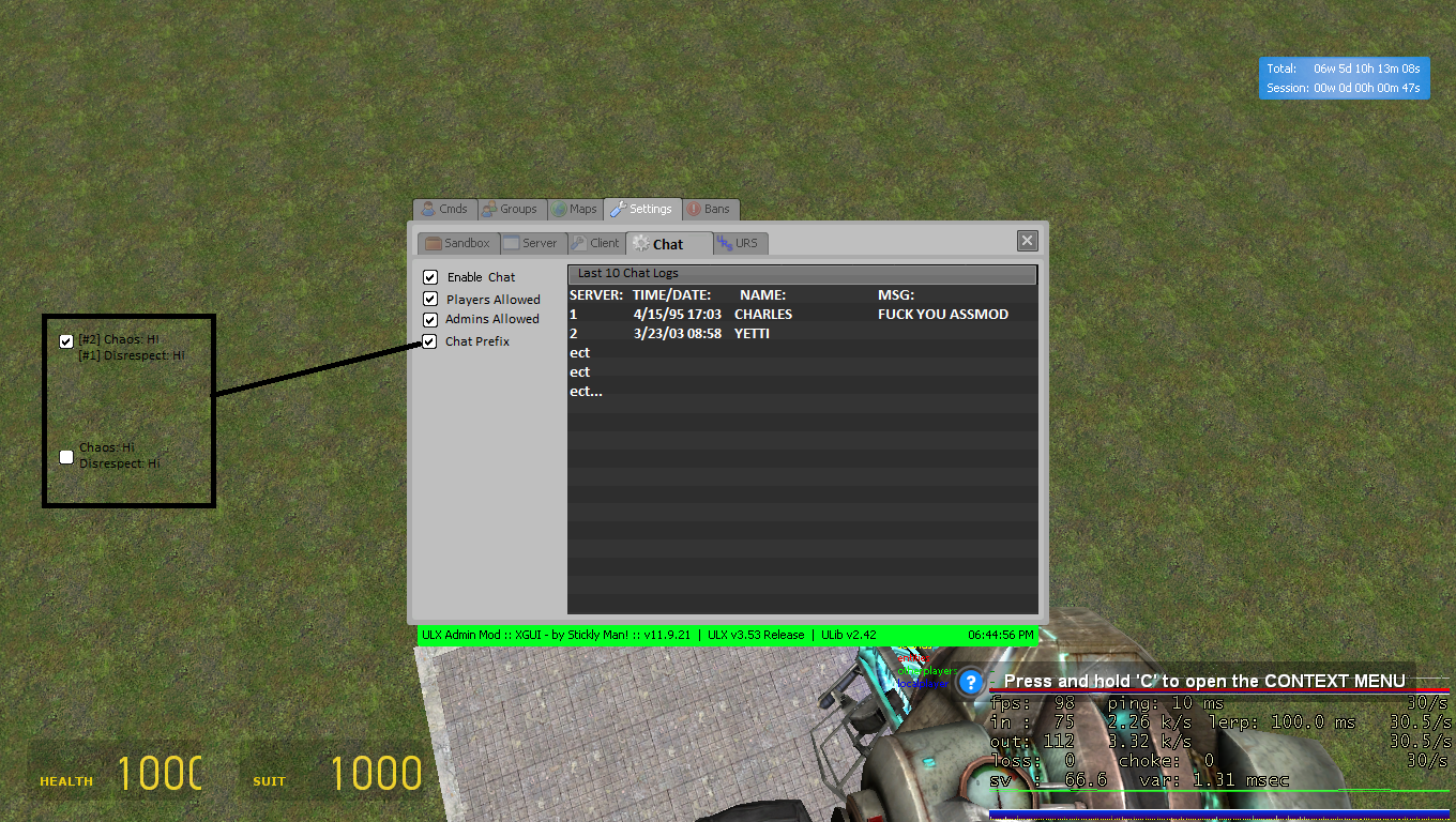

This is just a suggestion (That's why I'm here), but I believe that someone with the skills of lua and ulx should create a multichat command for two or more servers. The reason that ulx would be involved in this is cause (ulx is great and the best) [Look at Picture].

SQL is not a good platform for implementing a near real-time chat system. SQL is meant to store information, not pass it along. Yes, this is technically feasible, but it's much better implemented properly using sockets.
That aside, nice UI mockup for such a system. I don't currently have time to work on something like this, but maybe someone would be willing to pick it up. :)
I actually used my good friend [evo]Lead4u APromote's menu. Which I made in MS Paint...
