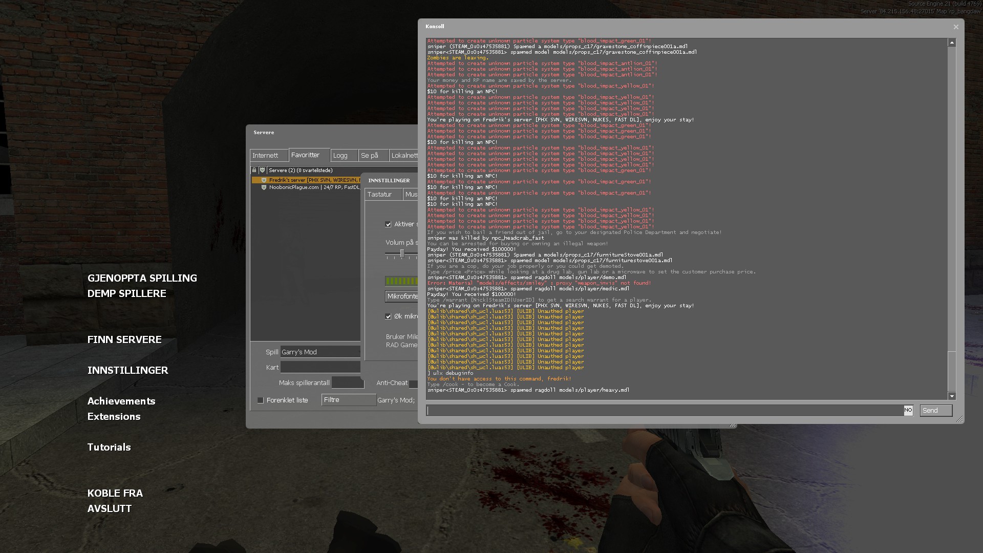

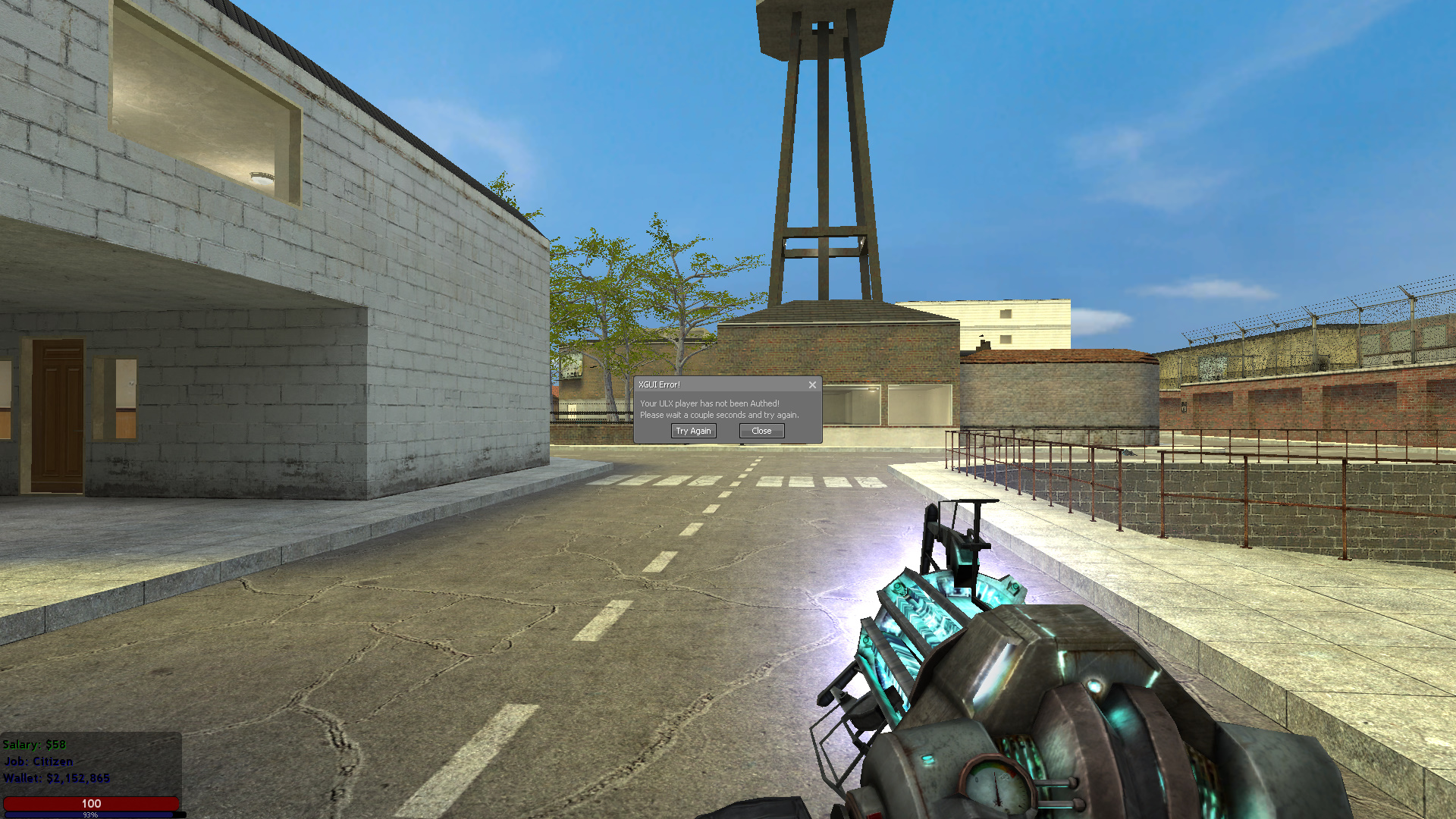

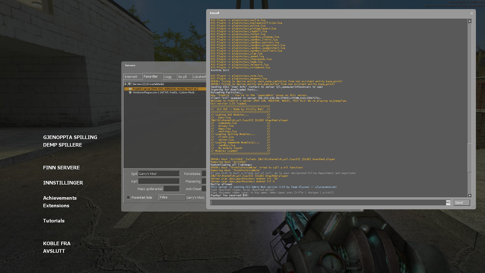

My problem is that I can't use ulx on my server. When I push the bidden key for xgui I get this message: "your ulx player has not been authed!" I think this is happening duo some conflict between different admin mods.
my server is  running Darkrp which comes with the Fadmin mod (Probably that's where the conflict is). I get the ulx to work if I put the assmod in the server, which is fine for me anyways. but when I put the assmod in I can't use any jobs or do anything on the darkrp mode.
I read in Fadmin's FAQ that you have to put yourself root_user through Fadmin to gain access to ULX, but that didn't solved the problem either. I also read many topics about this same problem on the internet but no solution seems to solve the problem. I tried deleting ulx and ulib and then updating them agian (im using SVN) but with no luck  :-\
I added some pictures as attachment.
Please help me !

Please run, from server console, with your own player connected to the server, the "ulx debuginfo" command.
It will tell you where it places a txt file. Report back with the data, attaching the file to your post, or using BB code tags [code]<results here>[/code].
If you get an error when running the command, give us the error, and the server startup log errors.
Or, is this a listen server, as that screenshot is from a game client console.
