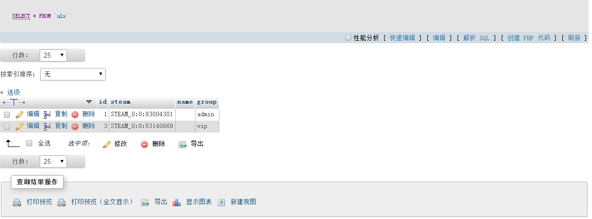

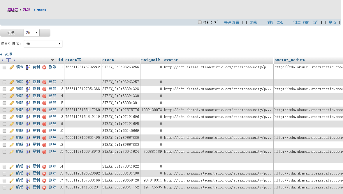

« Reply #71 on: October 09, 2014, 02:29:20 am »
Data line error.
System is Windows Server 2008.
