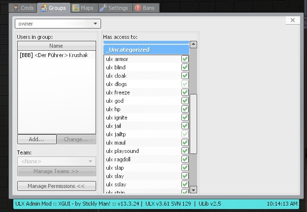

I run a TTT gmod server and today when I got on, some how ULX broke and all the fun commands are uncategorized thus leaving us unable to punish RDMers and etc.
I found the error.
[ERROR] addons/ulx/lua/ulx/modules/sh/fun.lua:1: unexpected symbol near '<'
  1. unknown - addons/ulx/lua/ulx/modules/sh/fun.lua:0
What does that mean?
And here is a picture.
Mind you I never changed any of the ULX lua files directly, only through the menu by using !menu

Re: ULX fun commands do not work
« Reply #1 on: April 03, 2013, 09:23:31 am »
It means regardless of what you think happened, your file was modified locally by yourself, someone else, or another program running on your system. It was modified in such a way that it caused a conflict when SVN next tried to update your files.
To fix: Recheckout the files and ensure that local edits do not occur in the ULX files.
Offline Krushak
« Reply #2 on: April 03, 2013, 09:31:08 am »
And how do I check that? Mind you the only SVNs I have going is ULX, ULIB and the one for terrortown(Which is badking's TTT). No one has access to the FTP but me.
« Reply #3 on: April 03, 2013, 11:35:04 am »
It sounds like it was probably accidental, then. But SVN would not have created a conflict like this unless the file was edited.
Offline Krushak
« Reply #4 on: April 03, 2013, 12:24:38 pm »
Yeah or something with how nfoservers does it cause they have that web base server thing where it sets up things automatically and I don't mess with gmod.xrap unless I need to, know how or want to toy with it. I found a thread on nfoservers that has that line, line 594 and 1934 or somethibg like that. i could link u later after work. I fixed it by removing whatever line cane up so yeah.
