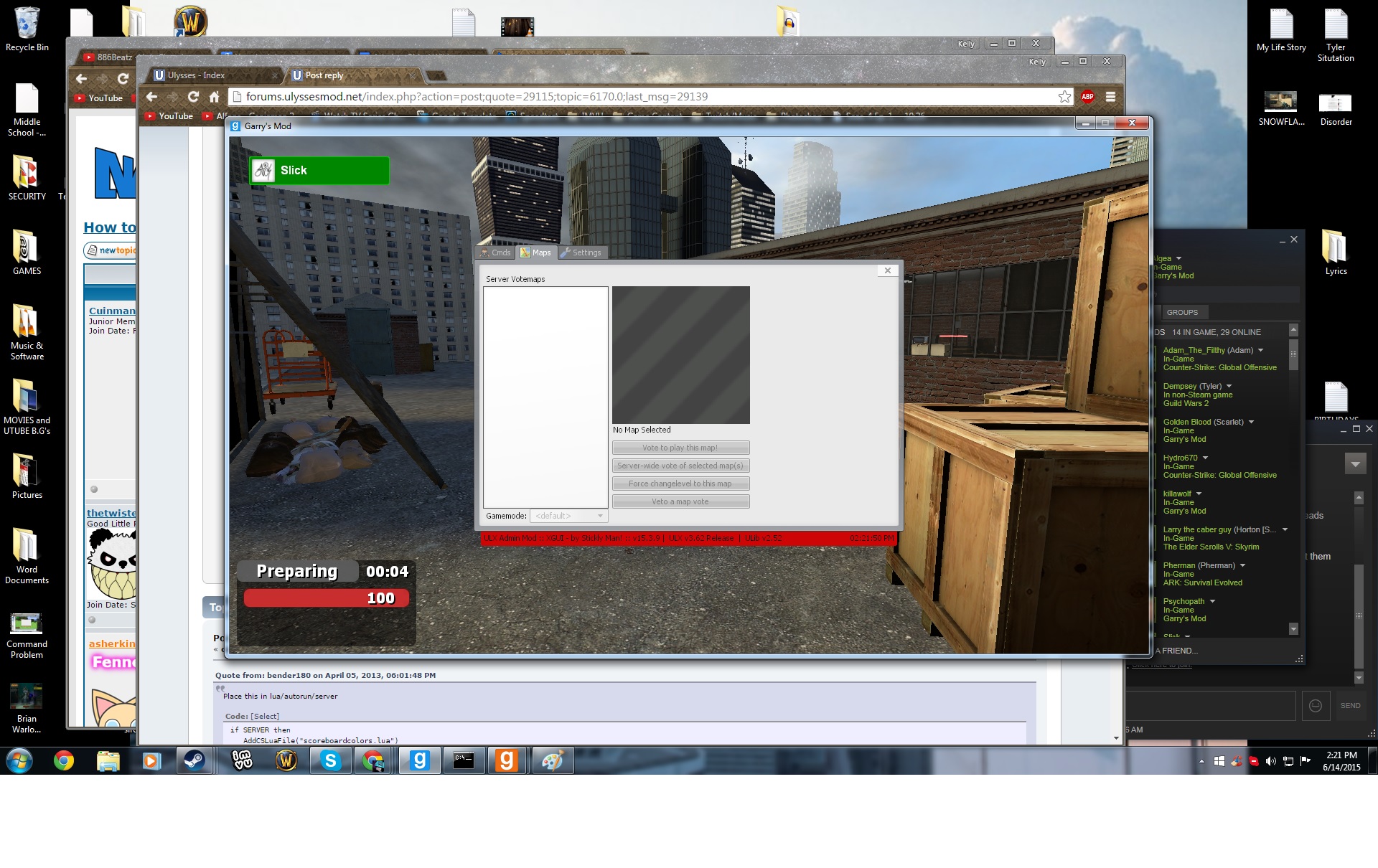

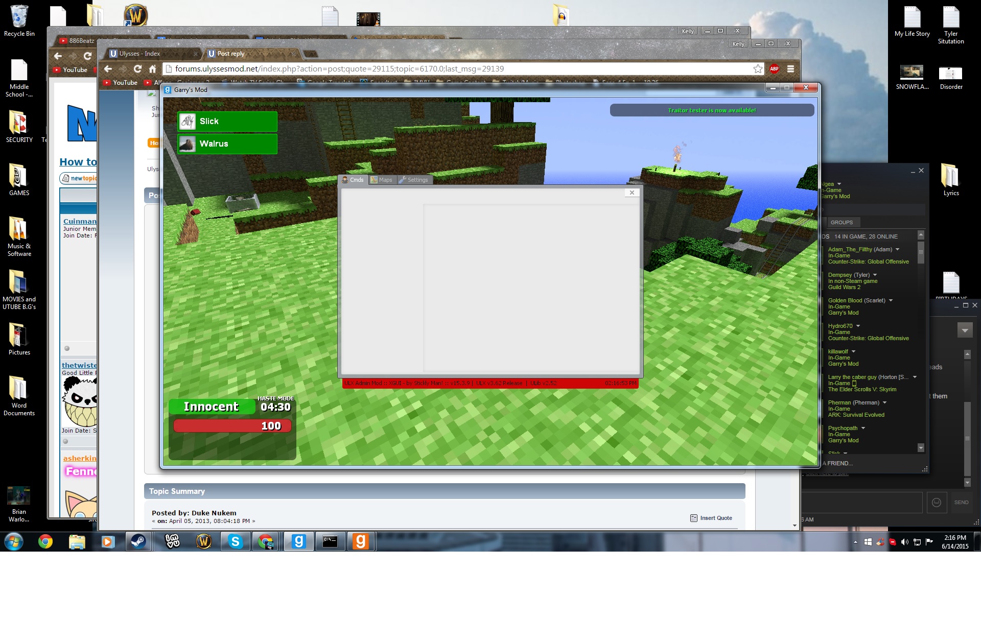

« Reply #14 on: June 14, 2015, 11:25:28 am »
You 'might' try copying gmod/addons/ulib/data/ulib/groups.txt to gmod/data/ulib ... then start server back up.
You'll most likely have to rebuild any custom groups.
I did this, and also had the same problem by not having any commands, ranks, or maps to choose from. My name is orange in the tab menu as if having superadmin, but have no commands. Could you please help me?
« Last Edit: June 14, 2015, 01:49:46 pm by Algea »
