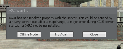

Hello i run a DarkRP server called SpectreGaming and recently i updated my Server and deleted my Ulib. So i naturally downloaded the newest one from GitHub along with Ulx because i saw some new changes. No when i start my server I get this error and My Xgui Gives me this screen. Could you please help me resolve this error.

The response from Xgui while in game is attached to this post

That was our mistake, razmo99. I've pushed a fix to GitHub, please redownload and report back.
