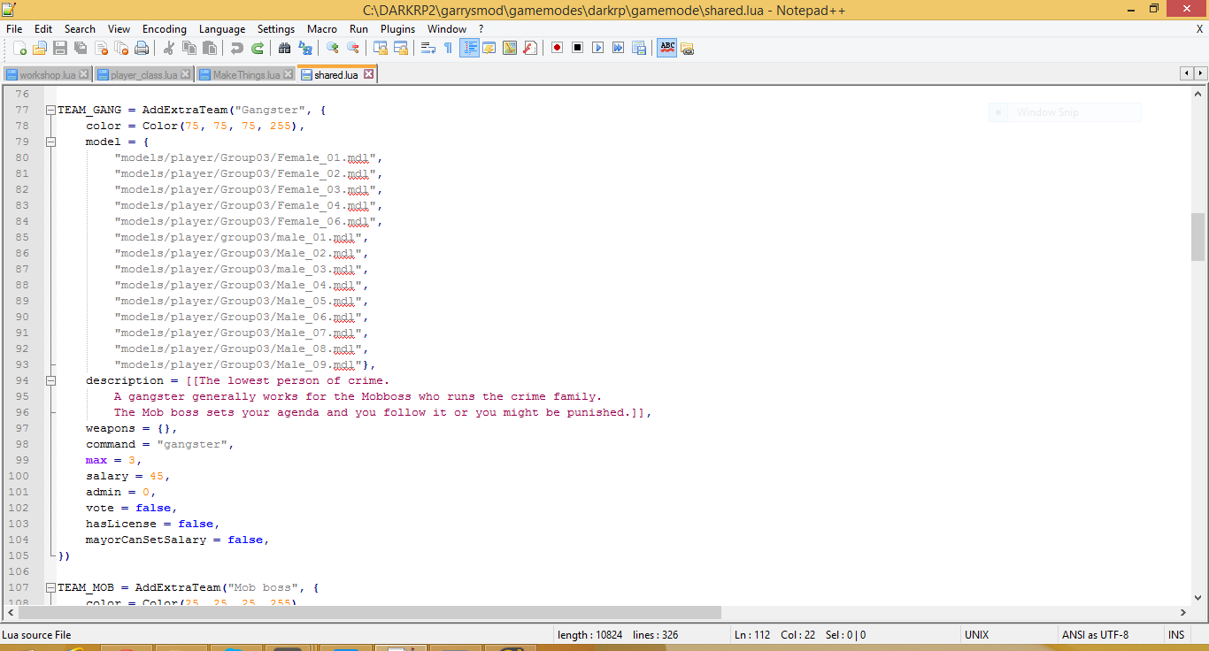

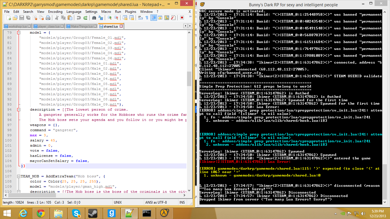

im getting an error saying "gamemodes/darkrp/gamemode/share.lua:115: ')' expected (to close '(' at line 106) near '='

Those line numbers aren't matching up.
