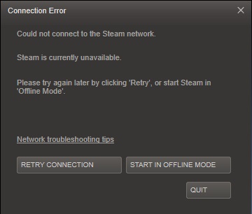

There seems to be a problem with Steam service (I noticed yesterday too).
See file in attachement.
