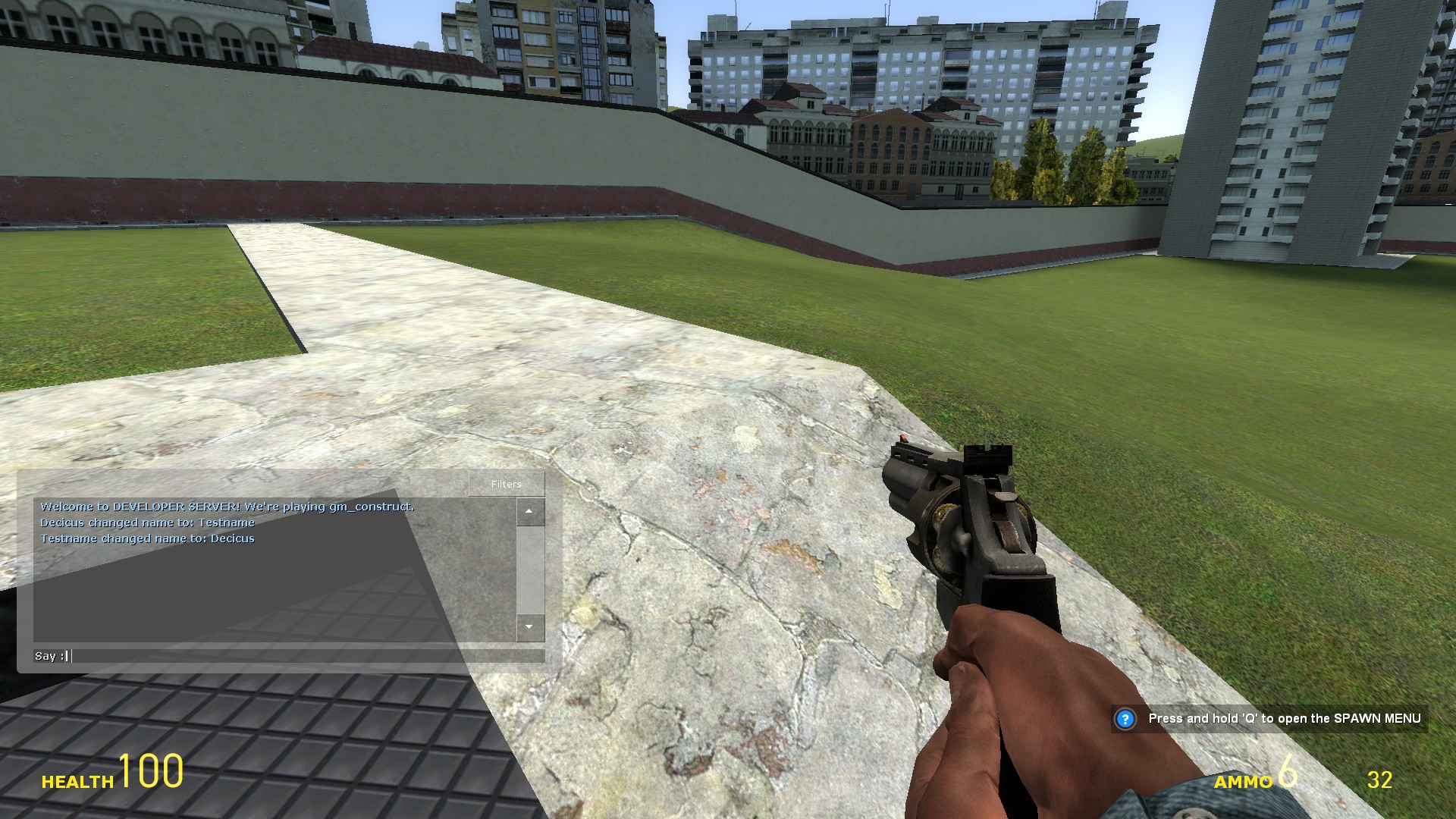

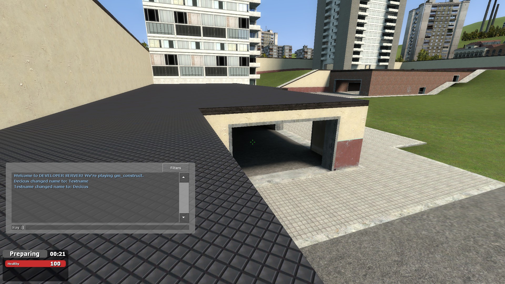

I tested it a few times, in both sandbox and TTT. It only printed once per namechange. I put screenshots below, where I changed my name twice per screenshot. So it could be a different script causing it, or something like that.
Sandbox:
TTT:
