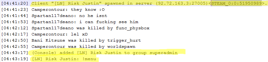

Last night around 1am a player connected to my server and gave himself superadmin in seconds of joining - The server is new however I copied over the same files that I use on my main server which may I say have never had a hacker that was able to set his rank before. (Had the odd speedhacker)
Now the weird thing is however I have another admin menu running at the same time called +ASS_mod which I use as a alternative however the hacker actually failed to give himself a rank on that menu which of course makes me wonder.
He was only able to make himself superadmin on ULX but nothing else? including the gmod in-game admin system.
There were no other staff during this time however one of the players messaged me as soon as it started.

He used console to add himself as superadmin, what makes this a ulx hack?
Ulx makes it easier for people to add themselves if they have console access (intended or not), but by all means, if someone you don't want has console access, you've got more problems than what ULX can help with.
Do you store your rcon password in your cfg files?
If so, there are many known exploits for reading a server's cfg files.
Please understand, by no means am I, or we (speaking for my team) saying with 100% absolute certainty that ULX isn't exploitable, but we are saying with confidence that your issue is likely not directly due to ULX.
ULX - we make things easier for administration, even for people you don't intend to (when they have console/r00t access)
