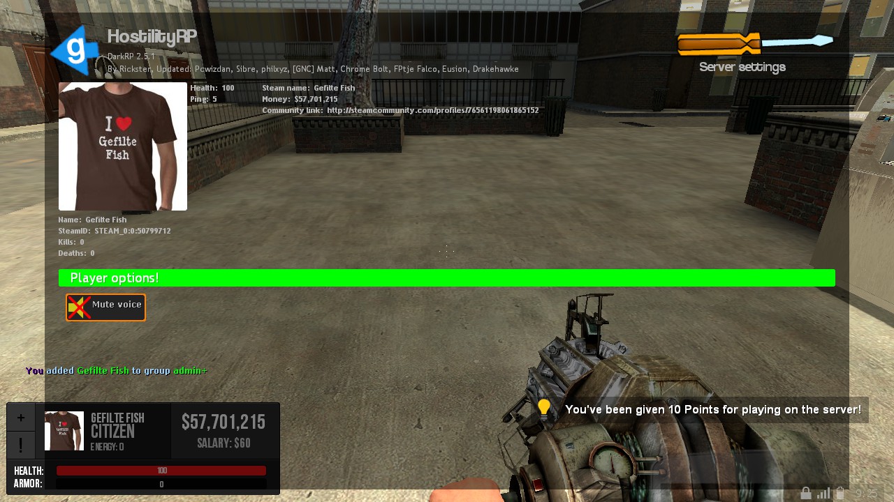

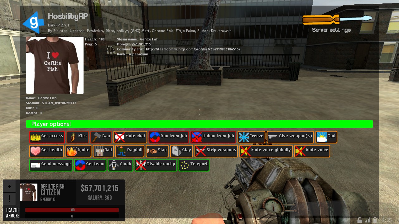

I need help with some of my custom ranks, i made a rank called moderator and had some commands like teleport,freeze,jail,etc.... but it dosent show in the scoreboard when i press my name and it dosent show the rank "admin+" when i switch to superadmin all commands and rank "superadmin" is there. Help

are they inheriting from "admin" or an admin rank?

« Reply #2 on: January 03, 2015, 05:40:26 am »
Yep

« Reply #3 on: January 03, 2015, 05:45:10 am »
ok first up, disable FAdmin. you're relying on it to show you your ULX ranks, which it won't.
next, confirm the actual rank by typing "ulx who" in console while you are that rank, if it says moderator or admin+ then it's just FAdmin being itself.

« Reply #4 on: January 03, 2015, 05:50:50 am »
Is there a way to still enable  FAdmin like most servers and it shows my available player options like freeze,jail like the superadmin

« Reply #5 on: January 03, 2015, 06:18:11 am »
You dont HAVE to disable it, I'm saying that's why you're not seeing your ranks. FAdmin doesn't show ULX ranks.

« Reply #6 on: January 03, 2015, 07:27:56 am »
FIXED IT. i just made a group in server settings :D Thanks for your help syst3M4TiK
