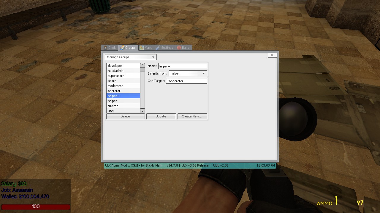

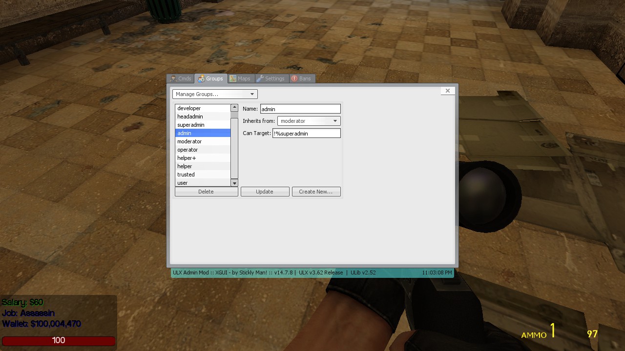

ok so i have a problem and i have a question.
i have currently 11 setup groups with ulx but my problem is that certain groups are allowed to pick up the owner which i dont know how but this is how i have it set up correct me if im wrong on how to fix it or something :)
i posted images so you can see how its mainly setup so if you guys can help me comment down below or email me at

In Gmod, superadmin is standard highest. If you just MUST have some other group higher, it should inherit superadmin.
(Team Ulysses does NOT recommend using higher groups. If you're gamemode/addon requires it, it's NOT standard Gmod group access)
Though ULib is capable of MUCH more than what I'm about to state, let's keep this simple for ever group control beginner.
Imagine your groups in highest power to lowest power.
2
3
4
5
6
7
8
Inheritance should start at top group, and work it's way down.
Can_target should start at bottom group, and !%<group_above> it's way up.
So if you just must have a owner group, it needs to inherit superadmin.

ok now question i screwed something up -.- so is there a way to add it ingame?
i for an inheritance? "owner" to inherit superadmin?
Re: ULX Rank perm help URGENT
« Reply #8 on: February 06, 2015, 08:39:09 pm »
Uh, you just posted pictures of where you do it. Group management. Select owner. place "superadmin" in inherit from.
I don't understand why you had to ask that.
