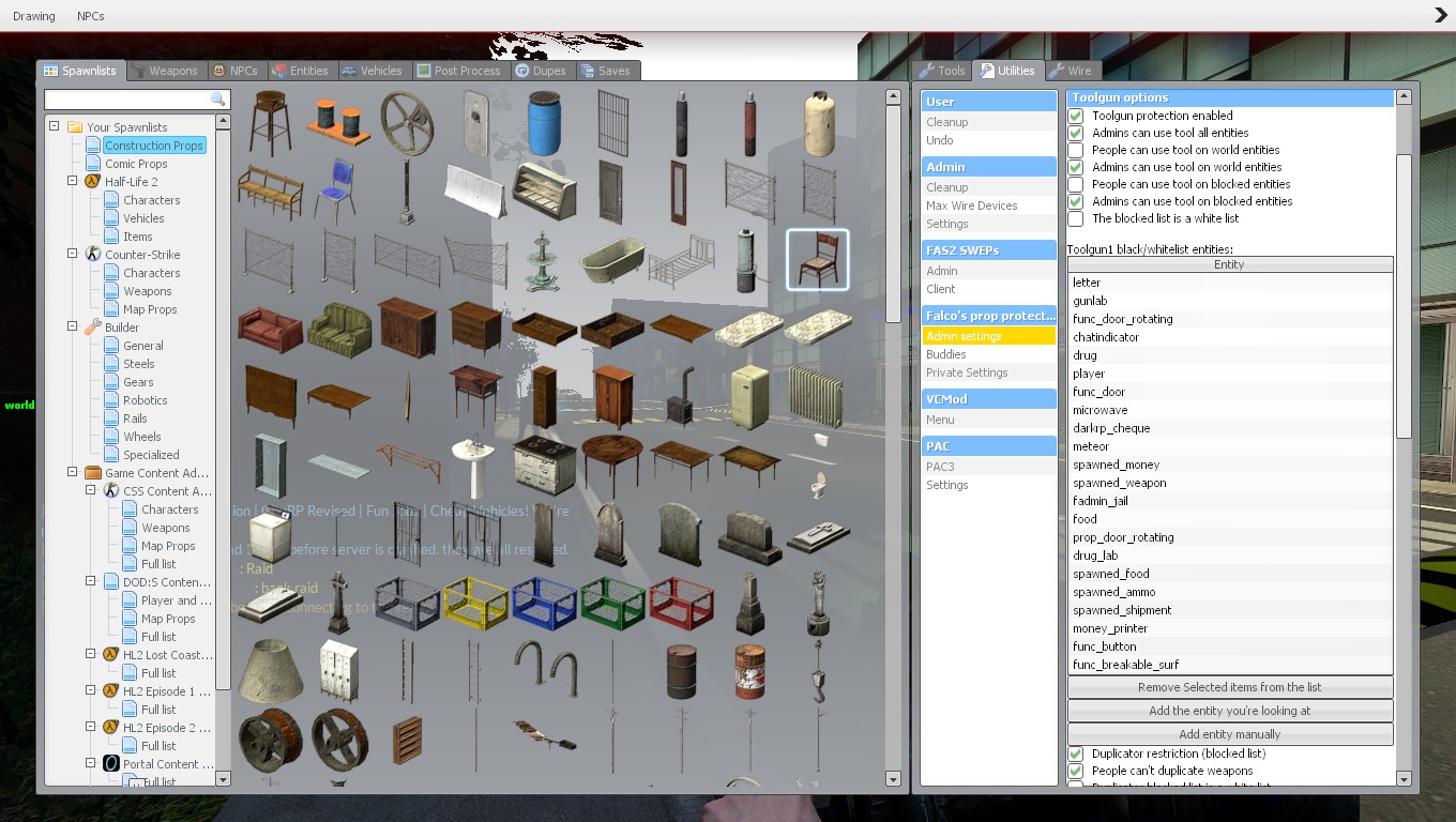

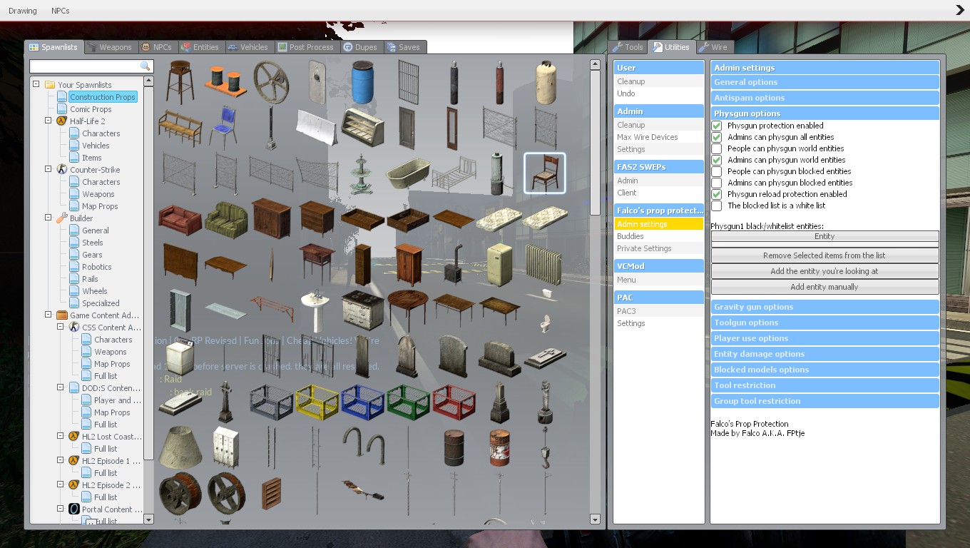

Offline DarkRiser15
  • Posts: 7
Re: How to add Remove and Physgun TDM cars using ULX Groups
« Reply #11 on: February 09, 2016, 04:14:14 pm »
Here is the screen shot for both Remover and Physgun.
Offline feldma
  • Posts: 47
  • Karma: 5
  • 5696 hours in Gmod and counting!
    • Mega-Strike Network
« Reply #12 on: February 11, 2016, 09:18:56 pm »
Check that the group inherits from superadmin.
That setup should be working in theory.
Solving 50% of people's questions by searching it up on google.
