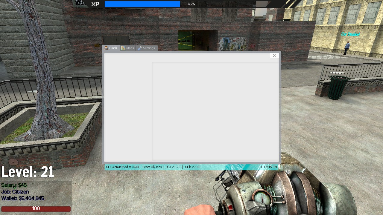

I'm having troubles on my DarkRP server. So I ran in to some hackers trying to take over my server they made themselfs superadmin and demoted everyone and then I banned them after that I demoted them but I couldn't demote one guy so I reinstalled ulx. When I restarted my server nothing worked I thought it was because I was using the wrong version of ulx and I might be (I don't know). But when I reinstalled it and pressed "M" to open up menu no commands where there and I was super admin, So no commands where there and the group tab wasn't there either. So I don't know what to do!

I keep on getting this:
KeyValues Error: RecursiveLoadFromBuffer:  got } in key in file In
AddonInfo,
AddonInfo,

I get this:
UPDATE DARKRP! UPDATE DARKRP! UPDATE DARKRP! UPDATE DARKRP! UPDATE DARKRP! UPDATE DARKRP! UPDATE DARKRP!
THE LATEST VERSION IS VERY GOOD, YES!!
VERY GOOD NEW FEATURES, REVOLUTIONARY CHANGES!
Then This:
Failed, using default cubemap 'engine/defaultcubemap'
A ton of these messages show up in my client console.

Looks like they hacked your DarkRP or some other addon allows exploit.
My recommendation - start from scratch.
Delete all addons/data/Gmod.
Re-install Gmod.
Re-install ULib and ulx.
Get yourself working as superadmin.
Then install latest DarkRP (as the hackers message seems to indicate you should have done originally to not have DarkRP or exploits related to it.)
Disable FAdmin.

Re-Install Gmod like the game?
Re: ULX Isn't Working! Please Help.
« Reply #9 on: April 06, 2016, 06:12:47 pm »
Yes, gmod the game. Unless it's a dedicated server, then reinstall the server.
