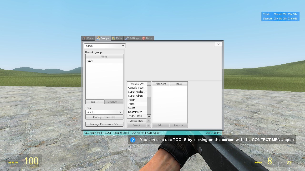

Is there anyway to copy teams? I'm trying to assign several groups with several teams; except these teams contain a lot of modifiers. It's a real hassle because I'm just renaming what is essentially the same team. If there is no way, can it possibly be added in the future?

I'm trying to make several groups which just have different names, making a new group is no problem, however when I want to assign a team to a group, I need more than one because I need them to have different names. Making a new team to assign to these groups is hard because I added a lot of modifiers to them. I'm trying to copy over these teams and then rename them instead.  :P

What you use to tell what rank someone is on the SUI Scoreboard. I can't really think of any other good explanation. I'm having trouble uploading a screenshot of it.
I also tried right clicking it for more options, but none came up

There is no "team" section in vanilla ULX. You likely have UTeam which gives you that. Looking at the config for UTeam, I see the config
"Out"
"teams"
"1" //Team index. Start at 1 and go up. Team priority lowest first.
"name" "Name" //Name of the team.
"group" "usergroup" //Usergroup required for the team. Works with garry's default and UCL.
"color" //The team's color
"r" "255" //Red value
"g" "100" //Green Value
"b" "0" //Blue Value
"a" "255" //Alpha Value
"hp" "500" //(*Optional*) Player's initial health.
"armor" "500" //(*Optional*) Player's initial armor.
"model" "gman" //(*Optional*) Player's model. (None if undefined, Kleiner if invalid) Valid models listed below
"plytable" //(*Optional*) Set values on the Player's table.
{ //Format is key:value
"1" "SprintSpeed:1000" //Set the player's sprint speed (Def. 500)
"2" "WalkSpeed:500" //Set the player's walk speed (Def. 250)
"gamemodes" //Gamemodes to load on
"1" "Sandbox" //To add additional increase number each time
I would presume you could go into this and add in your teams manually (copy and paste then change the values you need)

Alright, I got the screenshot to stop flipping out, these are the teams I'm talking about.

Oh. Well, I tried copying and pasting these teams after editing them into the groups file and then all the ranks got screwed up. Good thing there's a backup. I'll just lock this thread for now
Incorrect.
Sandbox mode, ULX allows associating teams with groups.
There is no way to copy them without editing the file, which of course, you must know what you are doing.
