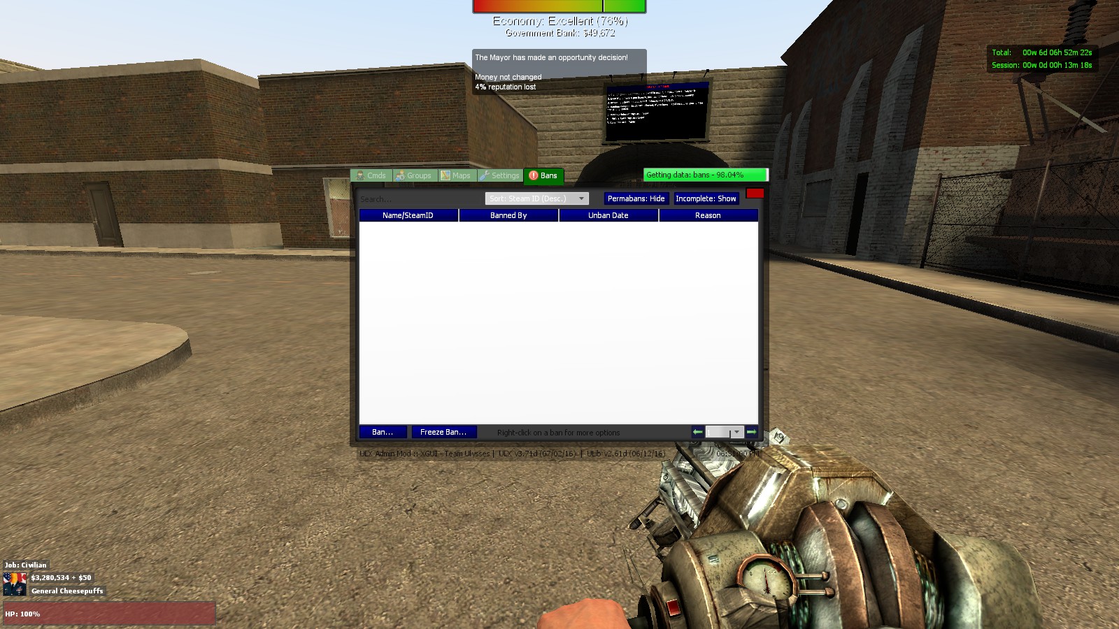

Bans not showing up in ulx menu
« on: August 06, 2016, 03:34:12 pm »
ULib v2.61d (06/12/16)
ULX v3.71d (07/02/16)
For some reason, whenever I open ulx menu, and go to the ban tab it doesn't show the bans, but is stuck on "Getting data: bans 98%". I checked the banned_user.cfg and it shows the bans. What is causing this what can I do?

[ERROR] lua/includes/extensions/net.lua:182: net.ReadType: Couldn't read type 96
  1. error - [C]:-1
   2. ReadType - lua/includes/extensions/net.lua:182
    3. ReadType - lua/includes/extensions/net.lua:121
     4. ReadType - lua/includes/extensions/net.lua:124
      5. ReadType - lua/includes/extensions/net.lua:124
       6. ReadTable - lua/includes/extensions/net.lua:124
        7. func - addons/ulib/lua/ulib/client/cl_util.lua:9
         8. unknown - lua/includes/extensions/net.lua:32
Not sure if it will help, but I just got this lua error
