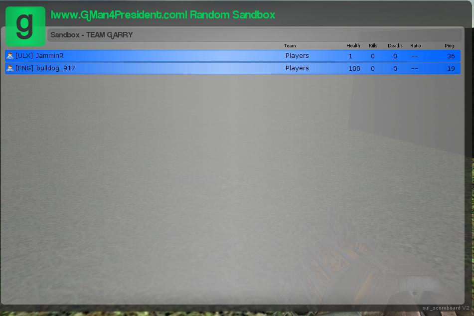

So I assume you guys aren't going to fix this.  Are there any other 3rd part scoreboards that work with ULX atm?
Re: sui_scoreboard - Sandbox Replacement Scoreboard REMIXED
« Reply #43 on: May 16, 2008, 05:49:00 pm »
This seems to be a problem with yours. No idea what it is.
It's not broken on any other server I've seen it on, including but not limited to UHQ and, G4P (5+ Servers)
See my attachment from a G4P server
So, we have nothing to fix, you do. :)
« Reply #44 on: May 16, 2008, 05:58:08 pm »
It works. There's nothing to fix.
Edit by Megiddo: Darn, JamminR beat me to it. I ran to UHQ to verify. :P
