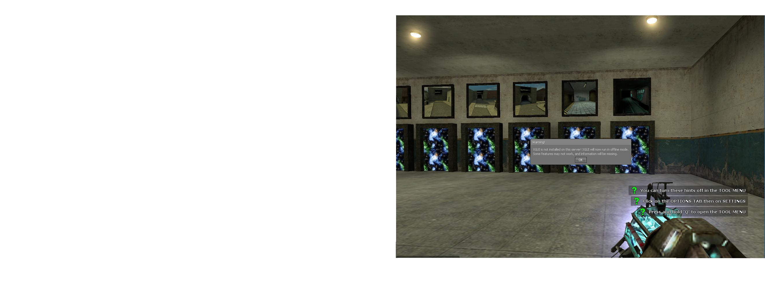

Hey guys, I just installed XGUI yesterday, and it worked fine all day,
but now I am getting a lua error when I try to click on the "Add" button of a group.
ulx\xgui\groups.lua:96: attempt to concatenate field 'group' (a nil value)
in this picture, when I click the "Add" button, the usual menu that appears where my mouse is/on the button is appearing in the upper-left hand corner, and I receive a LUA error.
I have the SVN of ULX and ULib, and I also tried reinstalling XGUI once, to no avail.
The only things I have really changed (besides removing UTeam, tweaking the motd, etc) are converting the UTeam teams into ULib groups-style teams, and adding sbox_limits to the .cfg
I had to add them to the .cfg, because when I changed them through XGUI, it wouldnt save over server restarts.
Please Help

@gte6495:
Just a hunch, but I think it looks like your groups.txt has an invalid entry.. or something. In your server console, run: "lua_run PrintTable( ULib.ucl.users )", and look for a STEAMID that doesn't have a "group = <blah>" value. You should either remove this entry or readd the entry so that it shows up properly.

« Reply #356 on: August 24, 2010, 05:38:46 pm »
I don't mean to re-post, but I felt it necessary in order to have this one seen :3
Removing all the broken entries fixed the bug :D, thank you!

@gte6495: I'm glad that fixed your problem! I put a tiny check in the code that will prevent that error from happening, and show the users' group as <none> instead.
