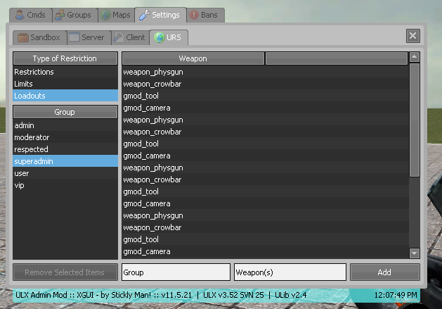

I have found an error.
The image is attached.
I did not add restrictions multiple times.

I was referring a bit more as to how you got this to happen.  Did you just come in game and the menu was like this?  Did you add the loadout and when it updated it happened?  Did you have the group selected when you added it?  Did this happen when you removed something?

The Loadouts section of the GUI would merge all the loadouts and add them to the list when any group was selected.
When you made a change the Loadouts of a group would change to numbers in the GUI.  This was because I messed something up on a for loop.
I could mess around with it a bit more and see if I can come up with anything.
Oh, I installed it by putting the add-on in the add-on's folder using SVN. Then when I went in game and checked the menu it had a globe not a URS icon. The restrictions for users I added through the menu, and then I added every other group using the commands that you specified in your first post. After I added them I looked into the menu and it was repeating over and over.

« Reply #74 on: July 07, 2011, 09:18:20 am »
I fixed your problem.  Update your URS.
