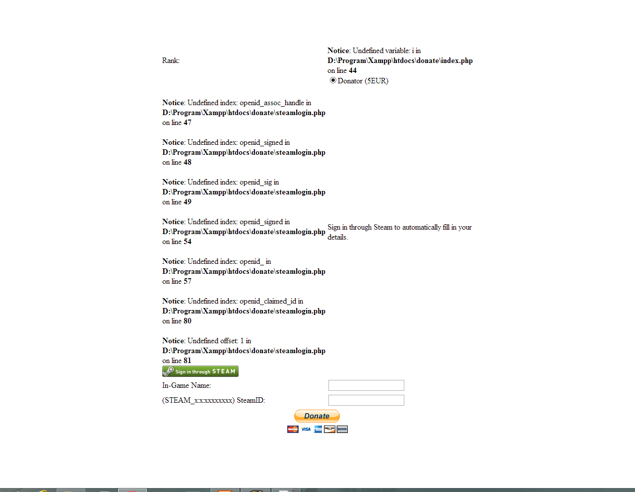

I attached a screenshot of what my finished donation page looks like and it has some kinds of errors that i would like help with.
Edit: I disabled these notifications inside the php.ini and it seems to be working as it should now.
Edit#2 Nvm when i press the paypal donate button nothing happens.
