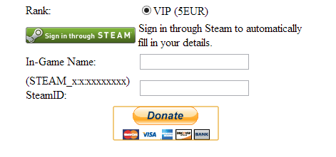

Hi I downloaded the Donation System and installed it but i have a couple of problems:
When you chose sign in through steam, it takes you to steam and when you sign in through steam it redirects you to wullysgamers.co.uk!  >:(
Next when you try to fill in your steam details manually it doesn't let you type in the boxes!
Any help would be greatly appreciated,
Cookie
Cookie
Did you try restarting it? Have you updated ULX?
