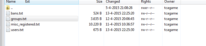

I tested it with bans and those just get written to a file fine and stay during a map change and server reboot.
See here all permissions for those files are all the same:
Its just with the custom made groups where i have this problem. People stay admin as well.
I the users file it states this:
